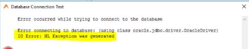

Issue Description:
The client has enabled SSL on their Oracle database; however, they are encountering issues when attempting to connect through AutomationEdge Process Studio.
Warning
Error Message:
User Defined Java Class.0 - java.sql.SQLRecoverableException: IO Error: No appropriate protocol (protocol is disabled or cipher suites are inappropriate)
