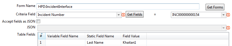

6
Criteria Field Value
Provide a value for the Criteria Field chosen above.
For e.g. to delete an incident record in form HPD:IncidentInterface_Create with criteria field RequestID you may provide the Criteria Field Value XXX, where XXX is an existing Request ID as shown below.
However, make sure all the required fields are available in the record for deletion. (For e.g. in case of CTM:People Status should be Delete and Site is required before deletion operation can be carried out).

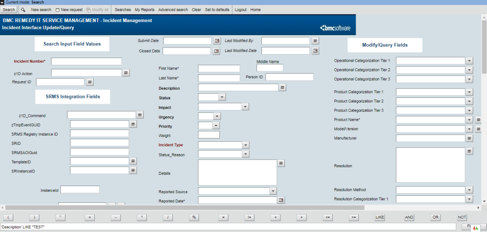

Query Criteria in BMC Remedy can be built by navigating to the Advanced Search on the form on which search is being conducted. The following is a screenshot of HPD:IncidentInteface in Advanced search.
On the bottom row you can see the operators that can be used in Criteria Query.
On the bottom Right you may click the Fields button. You have the options to select Fields, Selection Values (List of Values), Keywords and currency as part of query building.
Query built in BMC Remedy forms can be used in Criteria Query field of this plugin. However, make modifications as follows. Please note that elements on the left of the operator should be in single quotes and elements on the right should be in double quotes. Any * associated with mandatory fields should be removed before using the Remedy Query in the Criteria Query field.

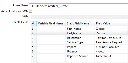

Following, is a sample snapshot of input tab with Table Fields with Static Field Name.

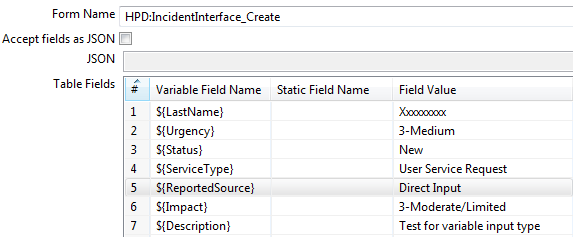

Following, is a sample snapshot of input tab with Table Fields with Variable Field Name.

Following, is a sample snapshot of input tab with Table fields populated.
Following, is a sample snapshot of input tab with Table Fields with Static Field Name. You may also provide variables in Variable Field Name instead of Static Field Name.
