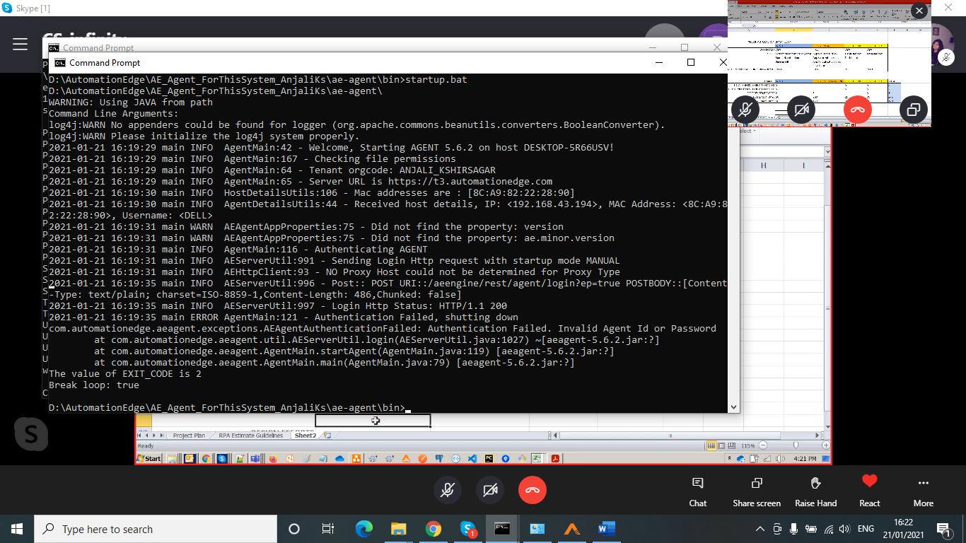

Issue:
Error while starting the agent:
com.automationedge.agent.exception.AEAgentAuthenticationFailed: Authentication Failed: Invalid Agent ID or Password
Steps To Reproduce:
- Try to run the agent from a different Machine_User other than Registered machine-user.
