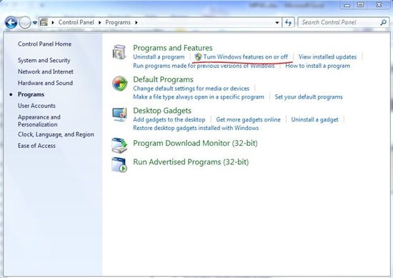

You must enable the tools that you want to use by using Control Panel. To do this, click Start, click Control Panel, click Programs and Features, and then click Turn Windows features on or off. (See the following figure.)

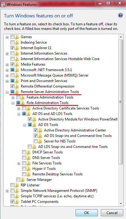

For RSAT on Windows Vista and Windows 7, you must enable the tools for the roles and features that you want to manage after you run the downloaded installation package. (See the following screen shot.)
Note: You don't have to do this for RSAT on Windows 8 or later versions.
To install Active Directory on Windows Vista and Windows 7, click on Remote Server Administration Tools, click on Role Administration Tools, check the AD DS and AD LDS Tools option and click on OK.

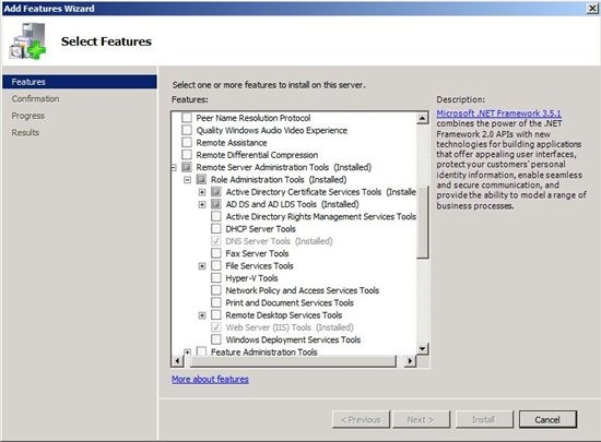

If you have to install management tools on Windows Server 2008, Windows Server 2008 R2, Windows Server 2012, or Windows Server 2012 R2 for specific roles or features that are running on remote servers, you don't have to install additional software. Start the Add Features Wizard in Windows Server 2008 or Windows Server 2008 R2 or the Add Roles and Features Wizard in Windows Server 2012 and later versions. Then, on the Select Features page, expand Remote Server Administration Tools, and then select the tools that you want to install. Complete the wizard to install your management tools. (See the following screen shot.)
