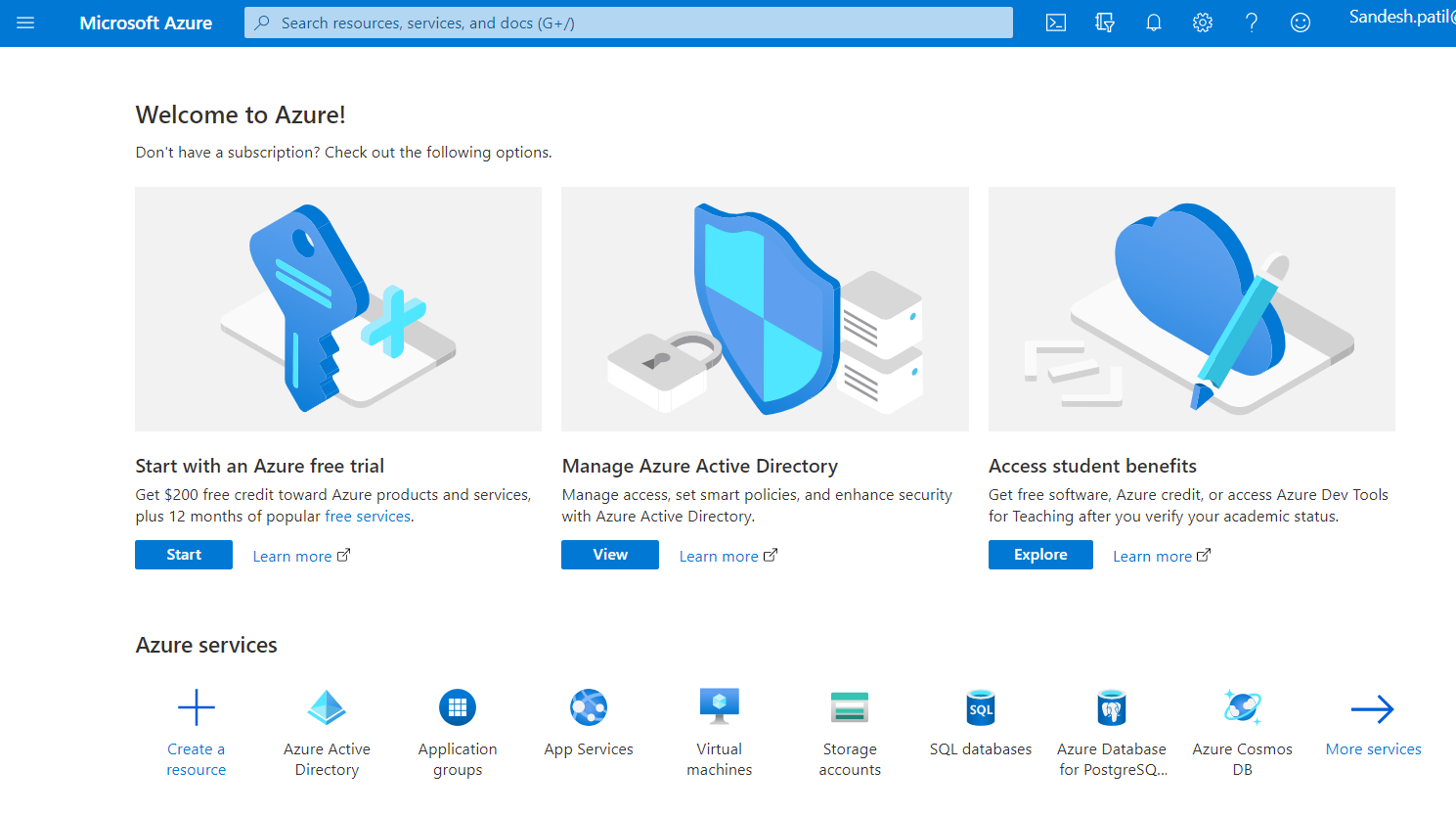

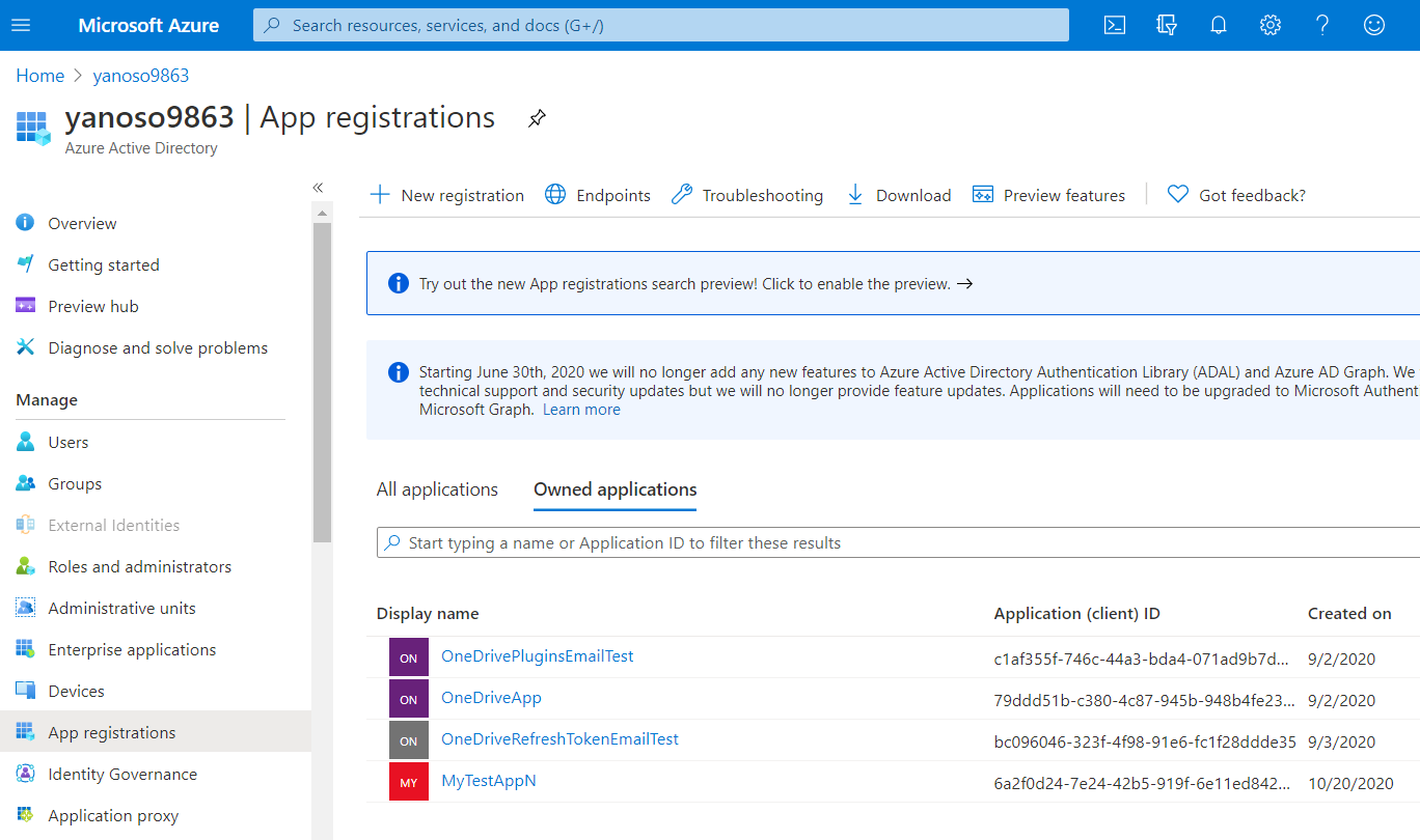

    On Home page click on Azure Active Directory

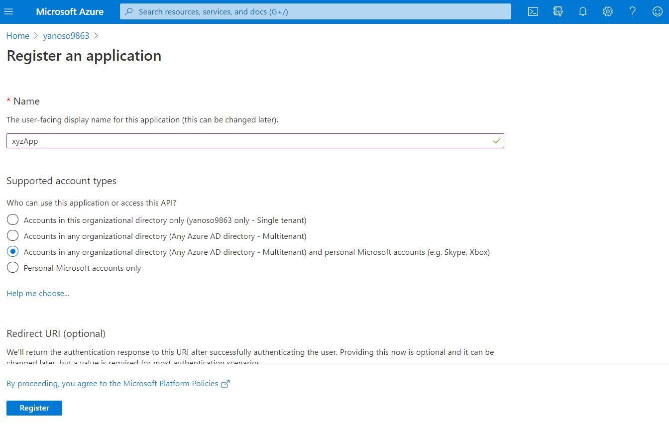

  1. Click on App registration in the left menu
  2. Click New Registration
  1. Provide an application name (e.g. xyzApp). Click Register.

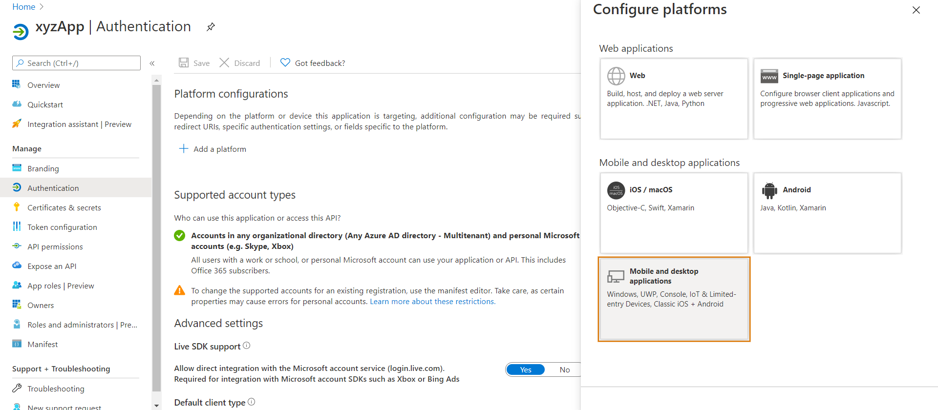

  1. Click on Authentication on the left menu.
  2. For you App under Authentication click +Add a platform to open the right panel as seen below.
  3. Select Mobile and desktop applications on the right pane.

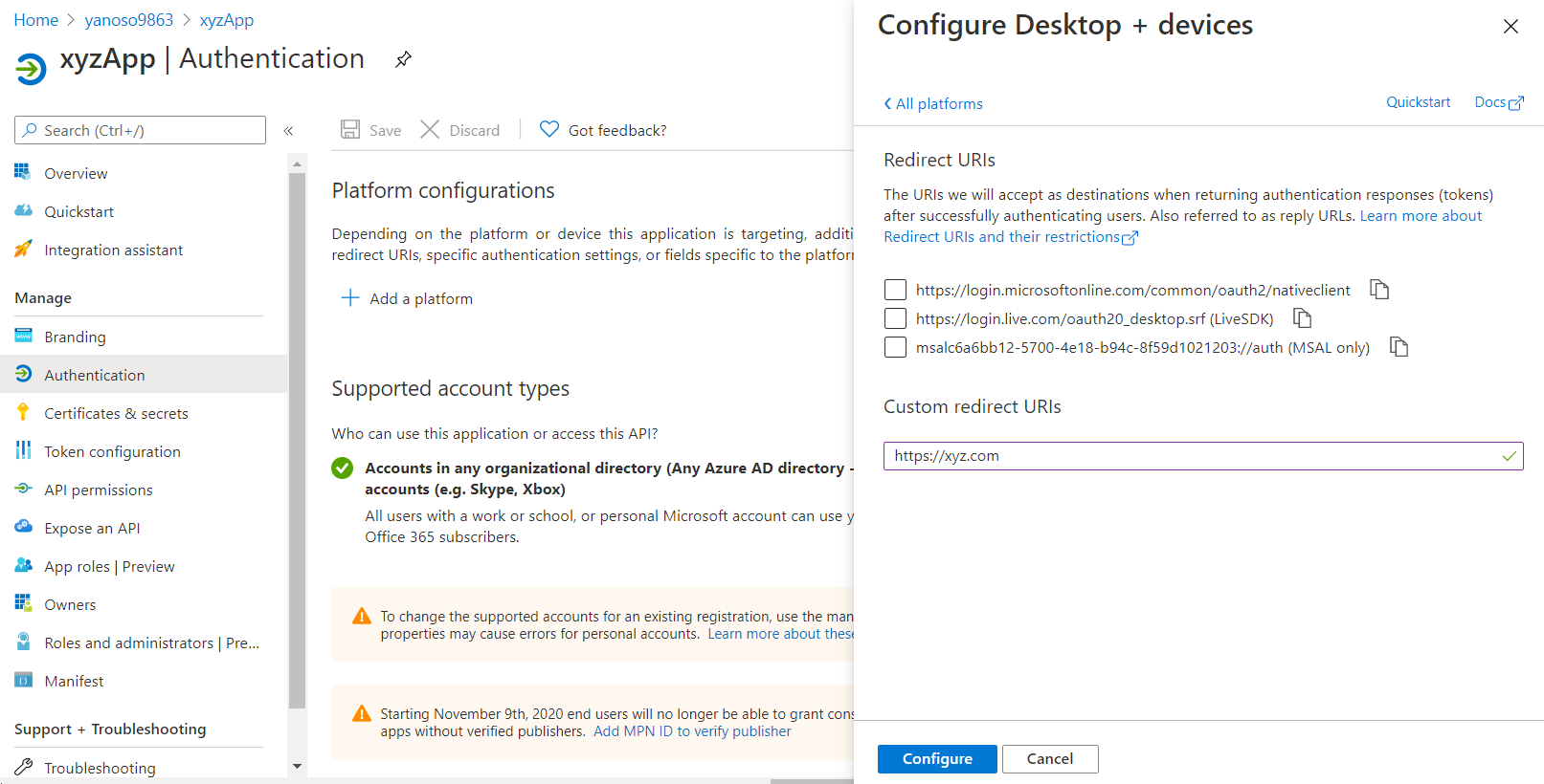

  1. Provide valid ‘Custom redirect URI’s’ to receive the authorization code (e.g. https://automationedge.com).   Click Configure button.
  1. For information on setting up redirect URI refer:
https://docs.microsoft.com/en-us/azure/active-directory/develop/reply-url

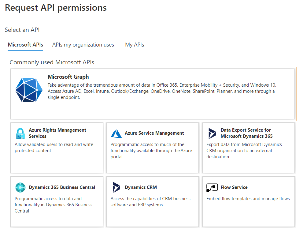

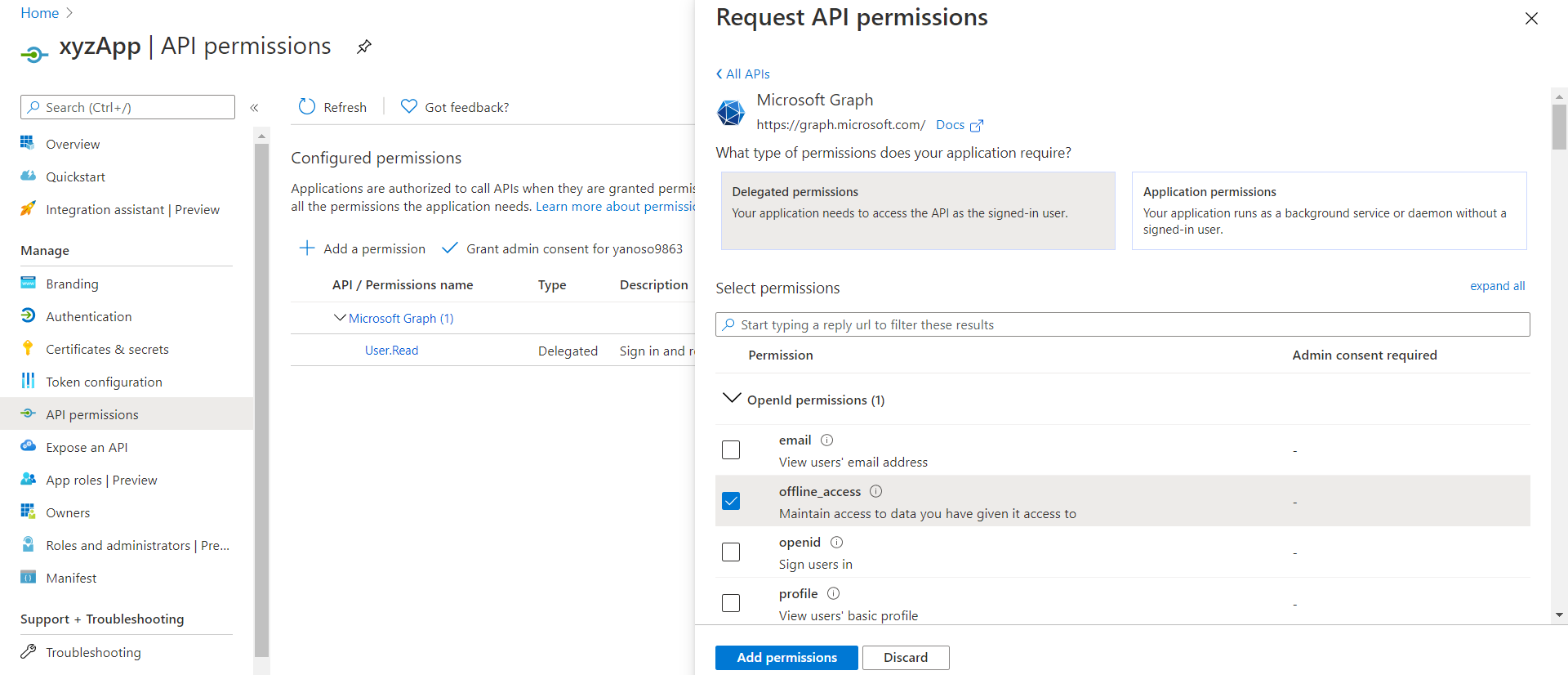

  1. Click on API permission in the left menu.
  2. Click on +Add a Permission
  3. Click the top tile – Microsoft Graph
  1. On the next page click on Delegated Permissions tile.
  2. Select offline_access as seen below and also listed in the table below. This is a mandatory permissions to generate refresh token.
Permission type
Mandatory Permission
Delegated (work or school account)
offline_access
