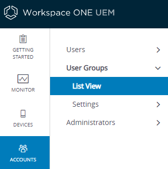

Specify the name of the Custom User Group in which enrollment user is to be added.
The available Custom User Groups can be found by navigating to AccountsUser GroupsList View menu in AirWatch.

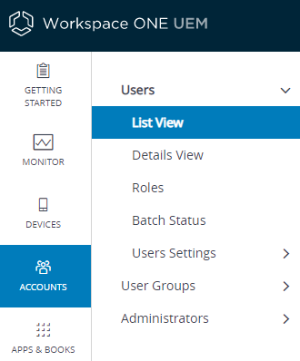

Specify the Enrollment username which is to be deactivated in AirWatch.
Existing Enrollment users can be found by navigating to AccountsUsersList View menu in AirWatch.
