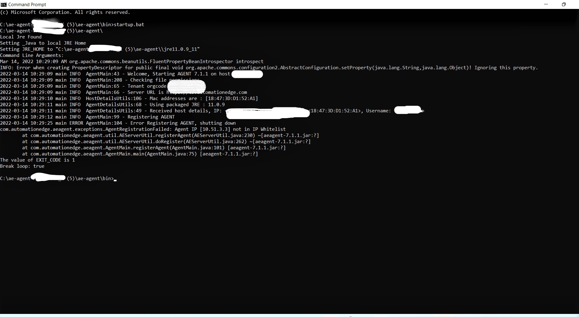

Issue:
While executing a new request we see that; the agent is in STOP state & not getting started after downloading a new agent.
This happens when we use invalid IP on server while we whitelisted & we get the below error:
Agent:
How to reproduce:
To reproduce this issue you can use IP/IP range/CIDR other than your system IP or 0.0.0.0/0
Resolution:
To resolve this issue we need to use the appropriate IP or 0.0.00/0 and remove invalid IP.
