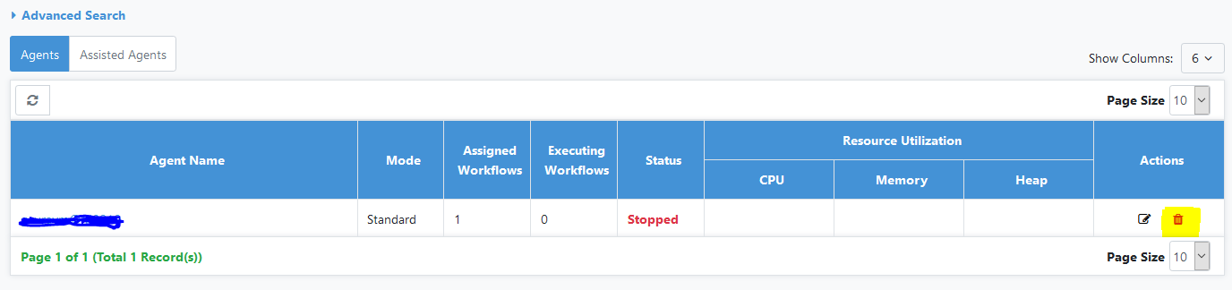

- Open portal server T3 https://t3.automationedge.com/#/home or OnPrem URL
- Go to Agent Tab and Delete the Agent as mentioned below :
