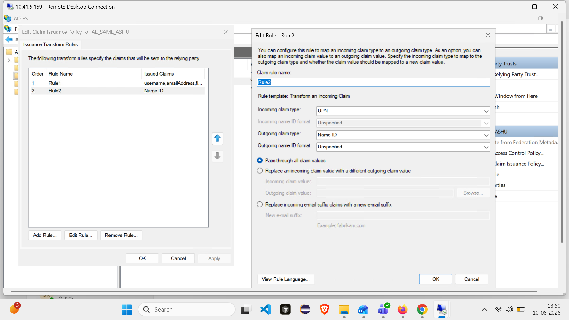

      • Rule 2
        Add another claim for the party trust. Follow step 4 (i) and (ii).
        In the Select Rule Template window, select Transform an Incoming Claim from the Claim rule template list, and click Next.
        Rule 2
        Transform an Incoming Claim template
        Select the following field details:
        • Incoming claim type: UPN
        • Outgoing Claim type: Name ID
        • Outgoing name ID format: Unspecified
          Incoming claim attribute details
        Click Finish. You can see the two rules you created.
        Rules
        Configured claim rules
    You can edit the rules, if required.
