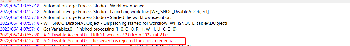

Error:
When working with Active Directory plugin we get the below message.
The test connection was successful in AD plugins, but getting an error as "The server has rejected the client credentials" when executed in process studio.
How To Reproduce:
Add special character '$' in the password to get the above error.
Resolution:
To resolve this issue, we need to check if there is a special character in the password, Specifically '$'.
If there is a special character, then please reset the password without it and run again.
