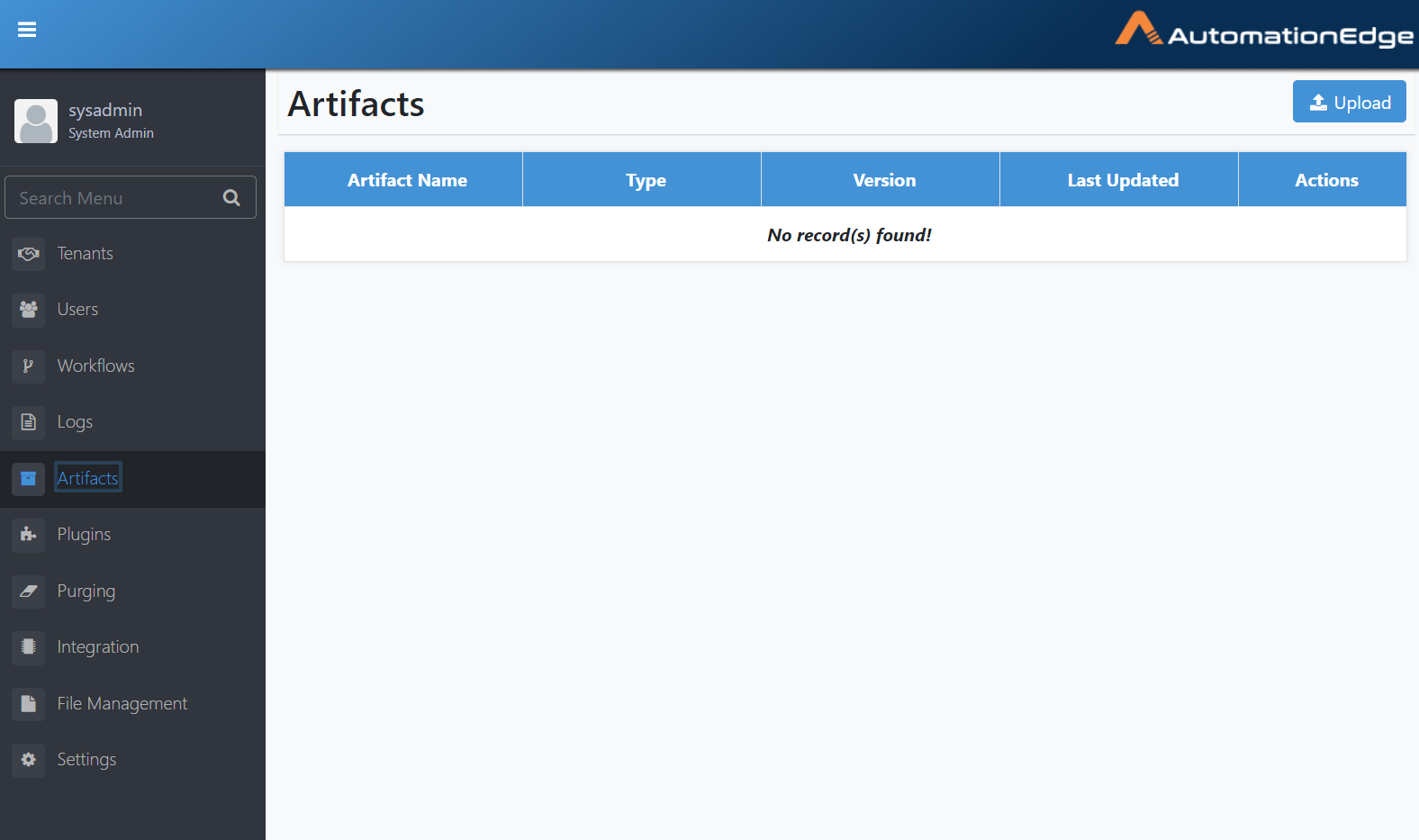

  1. Navigate to the Artifacts menu. Click the upload button.
Figure 8l: Upload Artifact

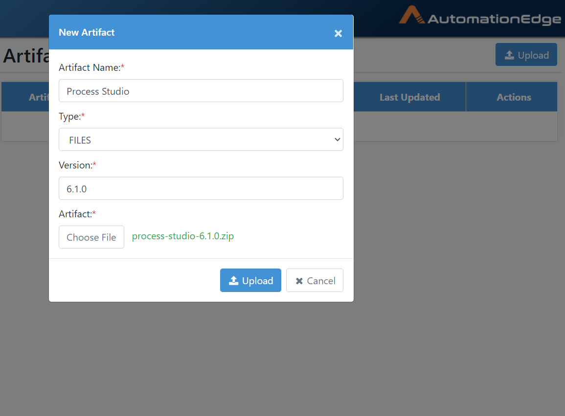

  1. The New Artifact pop-up appears as below.
Figure 8m: New Artifact popup
  1. The fields are explained in the table below.
Table: Artifact Configurations
No.
Name
1
Artifact Name
Specify the name of the artifact to be uploaded.
2
Type
Specify the artifact type. The default value for Type is FILES for now.
3
Version
Specify the artifact version to upload.
4
Artifact
Click ‘Choose File’ button to browse the artifact.

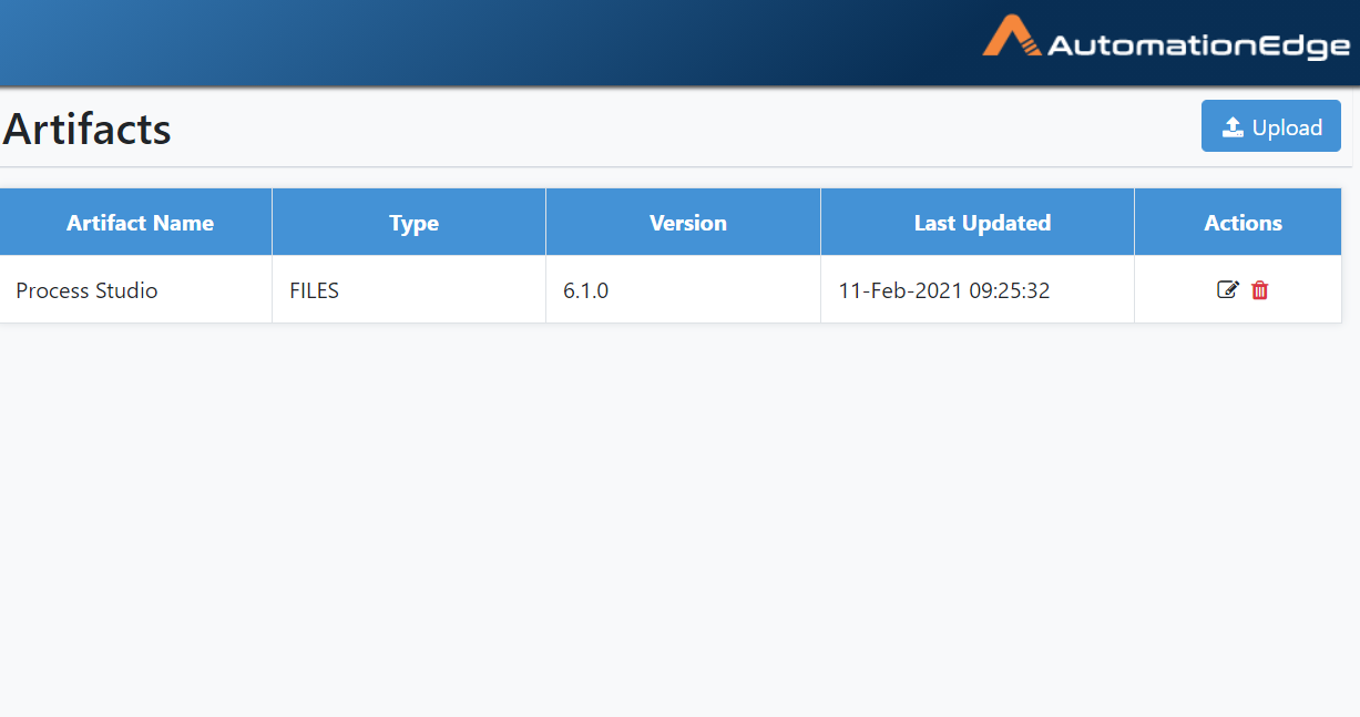

  1. Navigate to the Artifacts menu. It lists the uploaded artifacts.
  2. The Actions column has options for Edit and Delete on uploaded artifacts as visible in the screenshot below. The actions are described in the table below.
Figure 8n: Uploaded Artifacts List
Table: Artifacts - Actions
Action
Edit ()
Click on edit icon to edit/update the artifact.
Delete ()
Click on delete icon to delete the artifact.

  1. Provide the details in the New Artifact pop-up as follows.
    1. The artifact name as - Process Studio (this is case sensitive)
    2. Process Studio version to upload. The version should be compliant with AutomationEdge supported framework versions.
  1. Click Upload.
Figure 8o: Upload Artifact – Process Studio

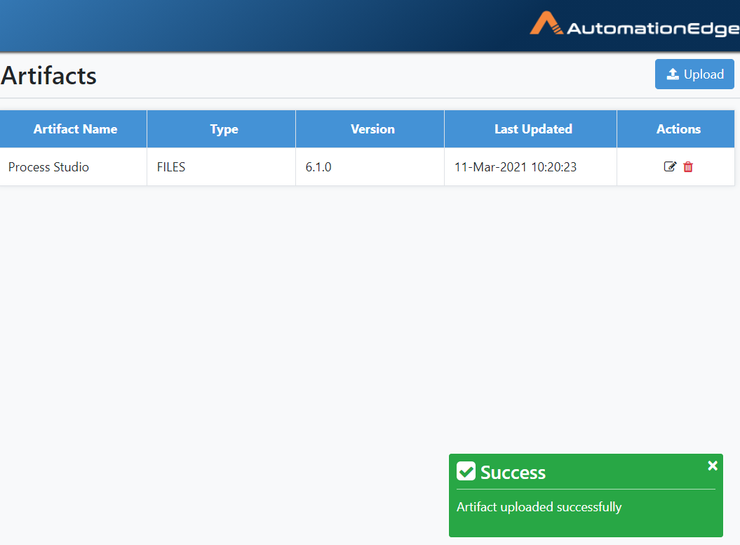

  1. Artifact uploaded successfully message appears, and the newly uploaded Process Studio is now visible as seen below.
Figure 8p: Process Studio uploaded
