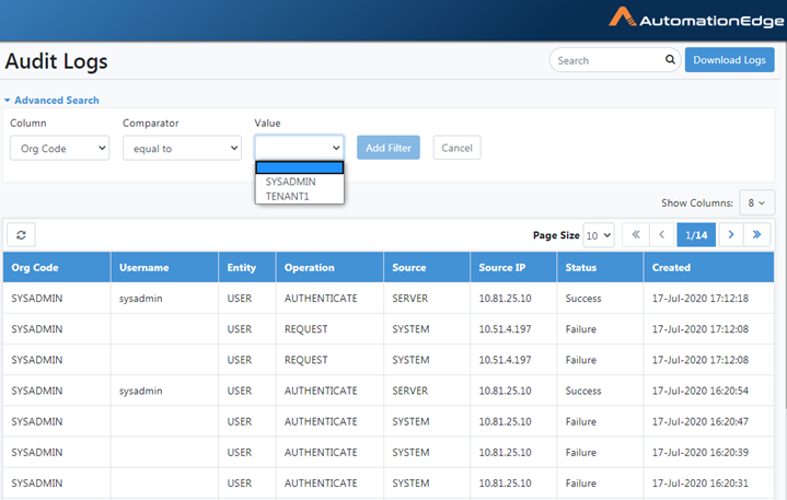

  1. Org Code is chosen in the first column below. The corresponding Comparators are visible. Select a Comparator.
Figure 8e: Advanced Search Filter Column
  1. The Corresponding Values for chosen Column and Comparator are seen in the drop down list. Select a Value.
Figure 8f: Select Comparator
  1. Tenant1 has been chosen below. Click Add Filter button.
Figure 8g: Add Filter

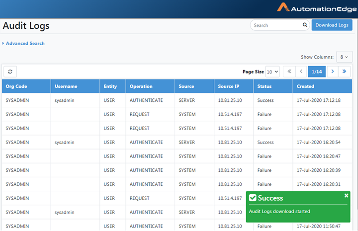

Audit Logs: Download
Click Download Logs Button at the top right corner.
  1. Download on the pop-up window the download Audit Logs as a .csv file.
Figure 8i: Download Audit Logs
  1. Success message appears showing Audit Logs download started. Figure 8h: Audit Logs Download Started
