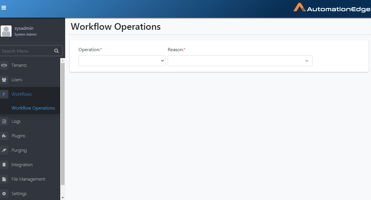

  1. Navigate to Workflows->Workflow Operations menu.
Figure 7aq: Workflow Operations

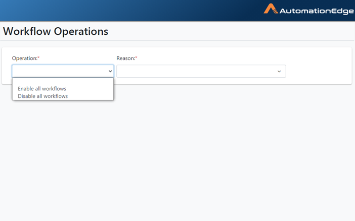

  1. Select an operation from the drop down list as seen below.
Figure 7ar: Workflow Operations list

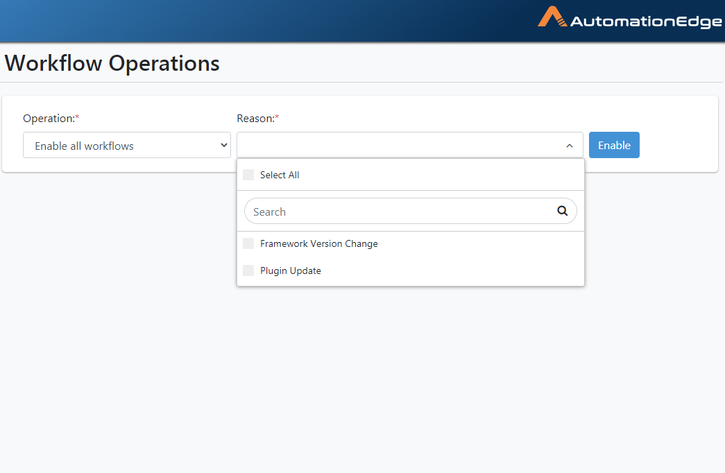

  1. Select a reason for the operation i.e. enable all workflows.
Figure 7as: Workflow Operation Reason List

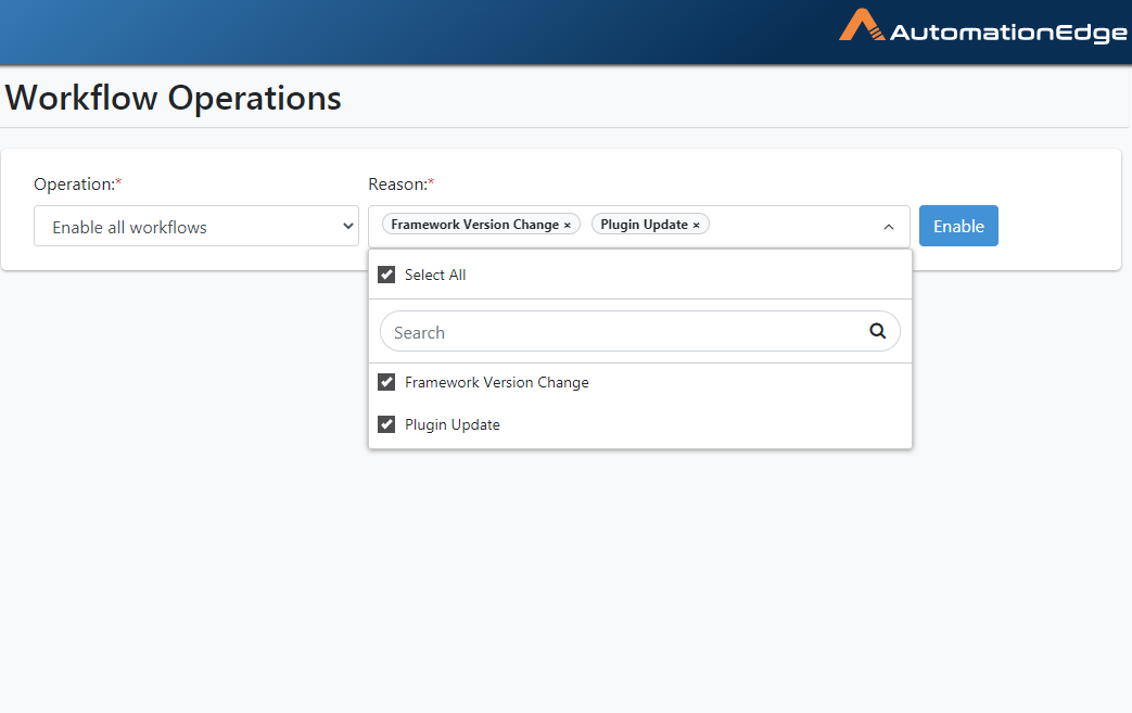

  1. Check the relevant reasons.
Figure 7at: Select Workflow Operation Reason

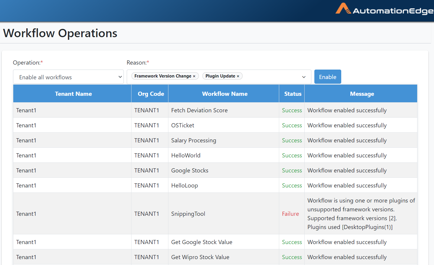

  1. Click Enable. Upon enable the list of workflows on which enable operation was done is displayed.
Figure 7au: Workflow List after Enable Operation

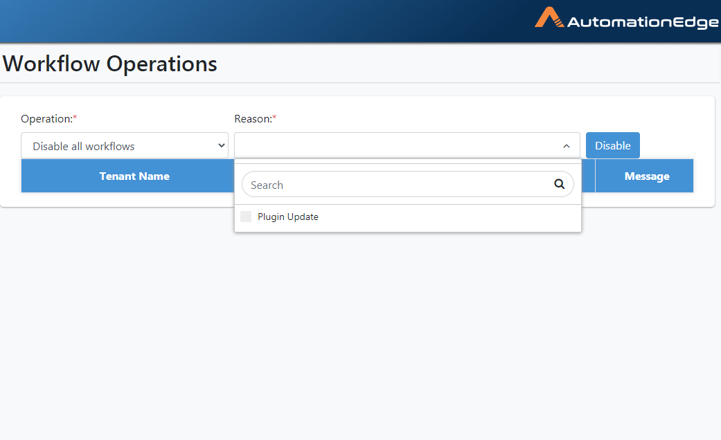

  1. Select Disable all workflows operation.
Figure 7av: Operation Reason

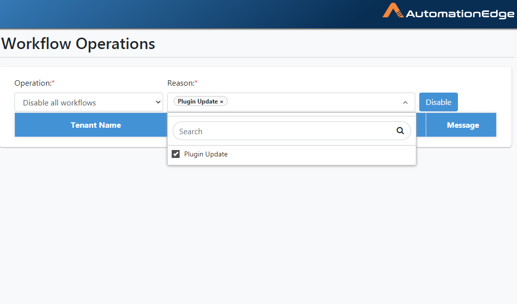

  1. Select the reason to disable.
Figure 7aw: Select Reason
