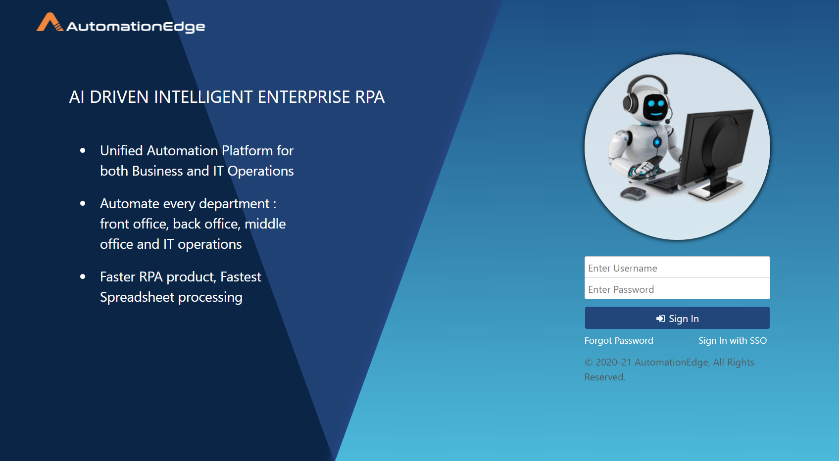

To login to the AutomationEdge:
  1. Go to the AutomationEdge URL.
  2. Enter the username and Password (Figure 1).
The Password should be alphanumeric. It should be a combination of lowercase letters, uppercase letters, numerals, and special characters. The minimum password length recommended is about 6 characters (Refer section System Administrator: Password Policy below)
Figure 1a: Login Screen
  1. Click Sign in. Figure 1b: Login Screen Sign In

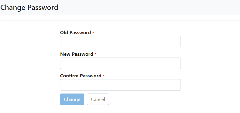

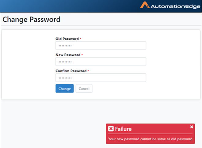

Change Password on First Login

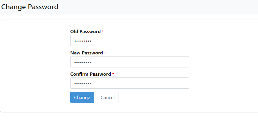

When user’s login for the first time the Change Password screen appears. Following, are the steps.

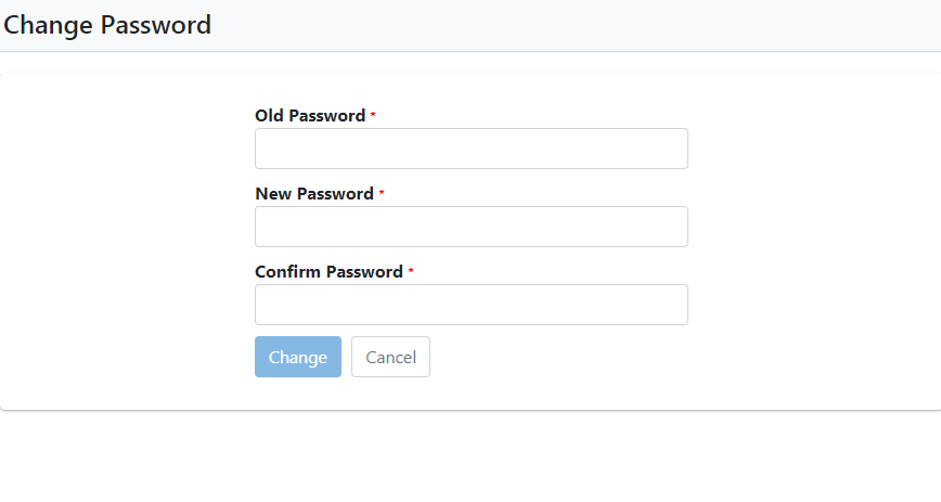

  1. The user is forced to change the password on first login. The Change Password screen is shown below.
Figure 1c: Change Password
Provide Old Password as well as New Password and Confirm Password as shown below. The new password must adhere to the password policy (Refer section System Administrator: Password Policy)
  1. Click Change to confirm the new password.
  2.
Figure 1d: Confirm New Password

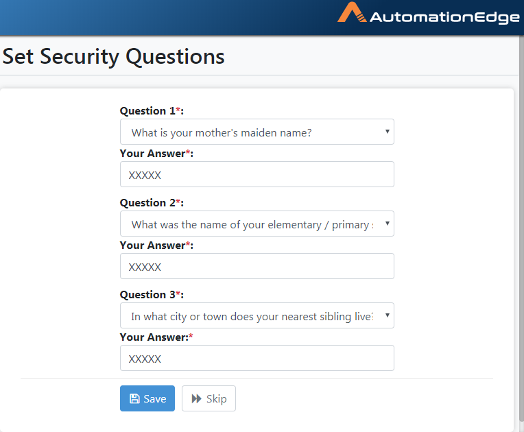

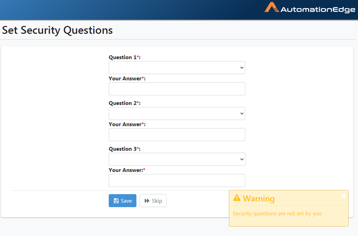

  1. Upon Sign in the Set Security Questions page is displayed. It also displays a warning message; Security Questions are not set by you. You may set questions and Save or Skip.
Figure 1f: Set Security Questions

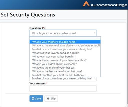

Set the three Security Questions as shown below.
  1. Choose from the set of questions as listed below. Select a question and provide an answer. Repeat this for the three questions.
Figure 1g: Choose from a list of Security Questions
  1. A sample list of questions and answers is chosen below. Click Save or Skip.
Figure 1h: Choose Security questions and answers

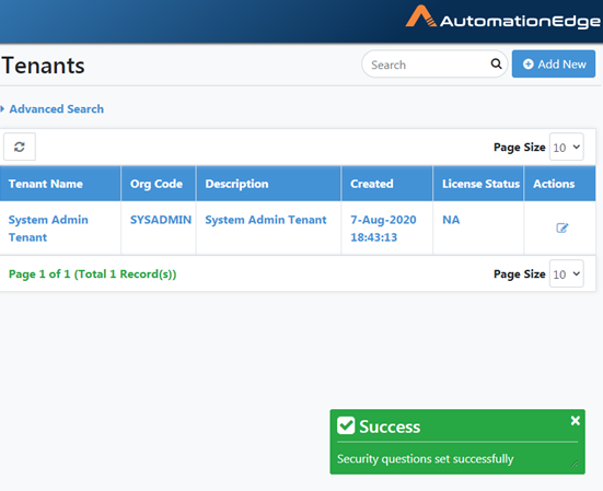

  1. If Save is clicked a Security questions set successfully message is displayed as shown below on the Tenant menu.
Figure 1i: Security Questions saved message

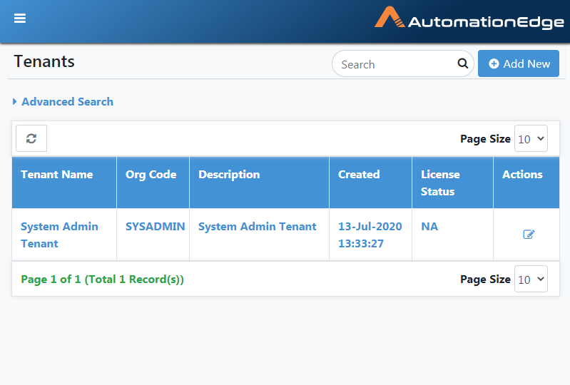

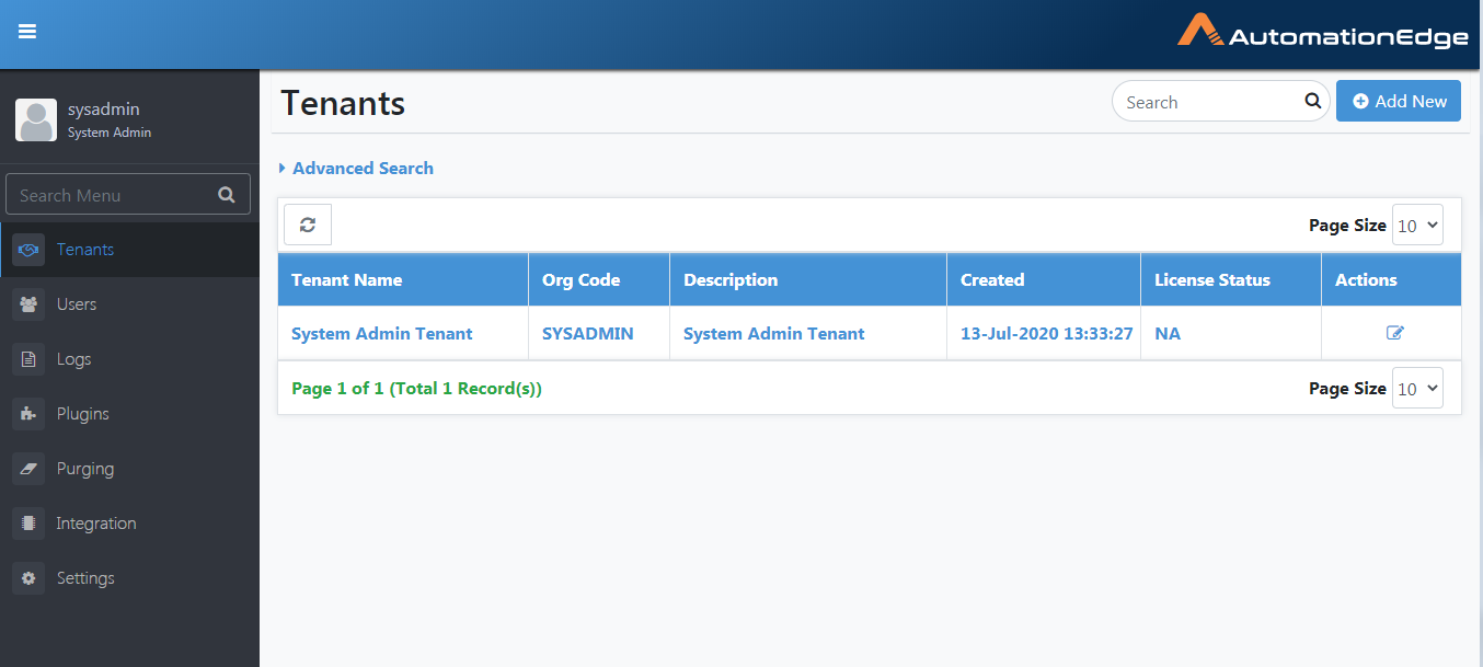

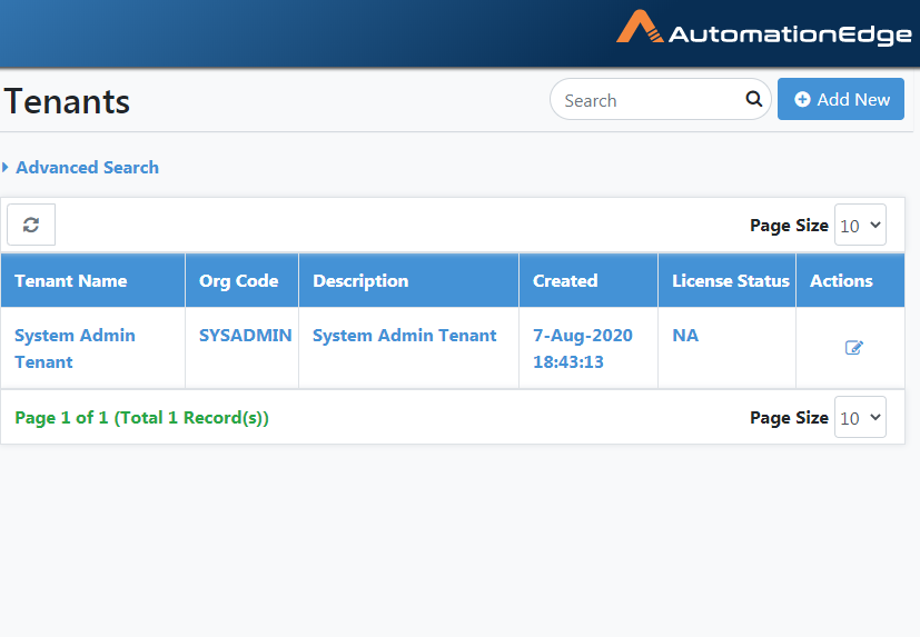

  1. If Skip is clicked Security questions are not set and it takes you to the Tenant menu as shown below.
Figure 1j: Successful login and navigation to Tenant menu

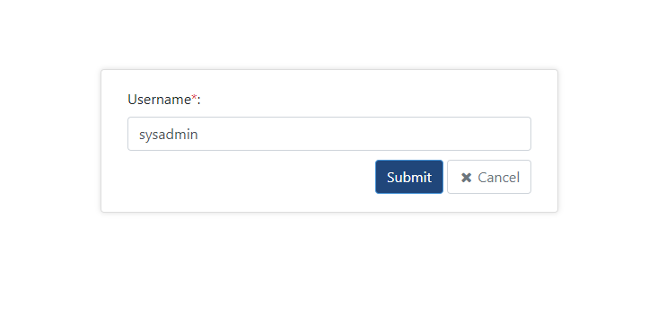

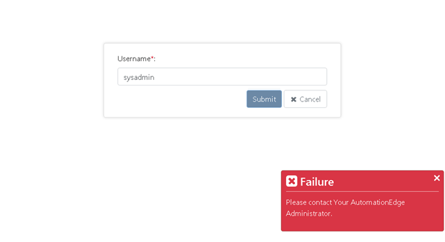

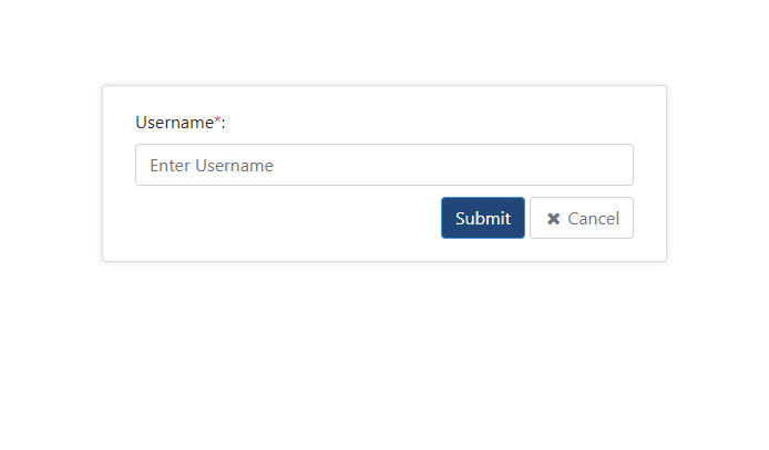

  1. A screen is displayed as shown below. Provide the username of a System Administrator user whose password is to be reset. Click Submit button.
Figure 2b: Enter Username
  1. Enter the System Administrator username for which password is to be retrieved.
Figure 2c: Username Sysadmin

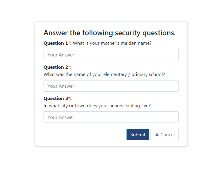

  1. A screen displayed with the security questions that were set for the System Administrator user.
Figure 2d: Security Questions

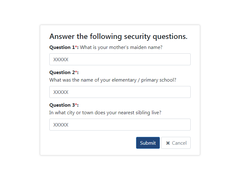

  1. Provide answers for all the three questions as shown below. Click Submit.
Figure 2e: All Security Question Answers

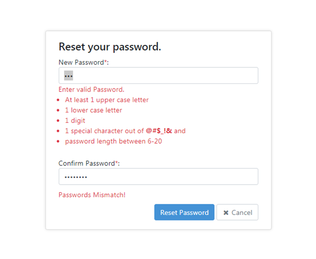

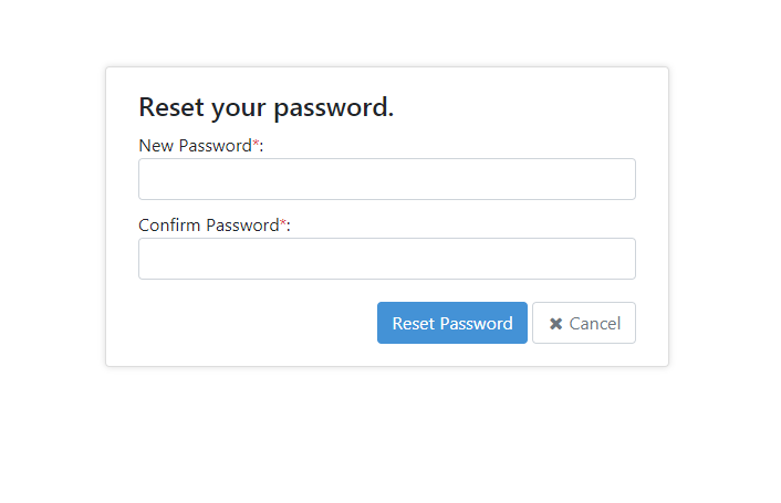

  1. If valid answers are provided a screen to reset your password is displayed.
Figure 2g: Reset Password
  1. If password does not comply to the System Administrator password policy, the password policy is displayed.
Figure 2h: Password mismatch

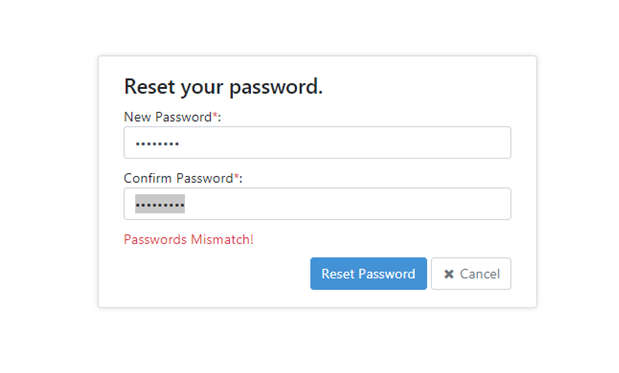

  1. Provide the New Password and Confirm Password. If passwords do not match it gives an error, Passwords Mismatch.
Figure 2i: Confirm New Password

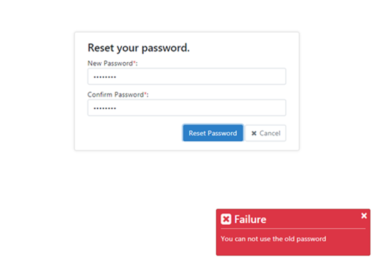

  1. If you provide the same password as your last password you get an error message, you cannot use the old password as shown below.
Figure 2j: Error on using old password

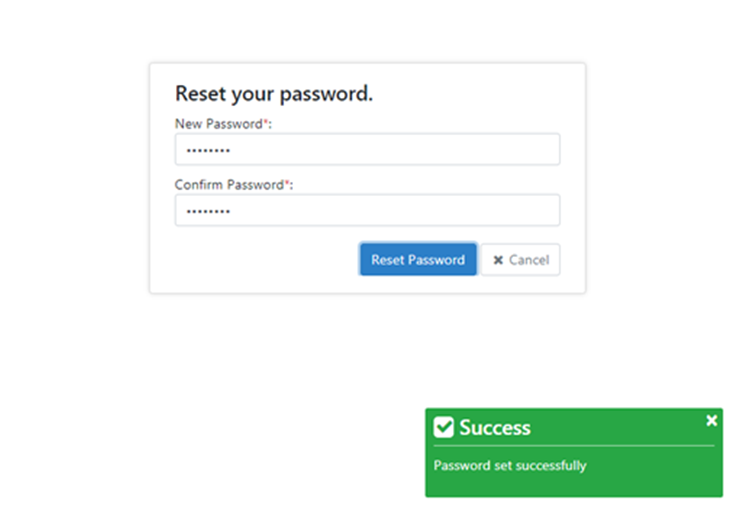

  1. On providing a password that meets the password policies the password is set and Password set successfully message is displayed.
Figure 2k: Password Set Successfully

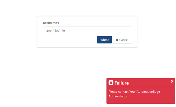

  1. If a user other than System Administrator tries to use Forgot Password functionality a Failure message as shown below is displayed.
Figure 2m: Others users cannot use forgot password feature

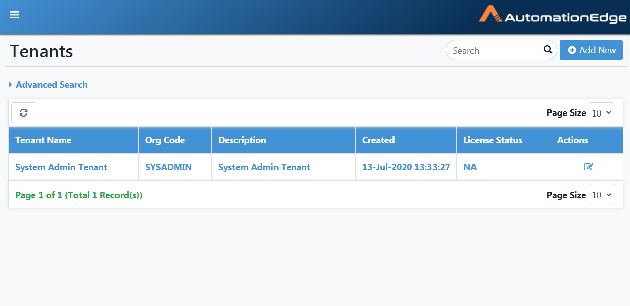

Home Screen
After logging on to AutomationEdge, following screen appears (Figure 4).
Refer Table 2 to for a description of Home UI.
  Toggle for Navigation Menu |
Figure 3a: Home Screen for System Administrator
Click toggle to get the collapse menu on the Home Page and see the full page view. The toggle can be used to expand or collapse the menu view.
AutomationEdge UI has a responsive deign and it adapts to screen size and orientation on different devices. Alternatively, you may reduce the size of you page. Having a responsive UI design, it hides the menu and displays the page in full view.
Figure 3b: Home Screen for System Administrator with expanded Navigator

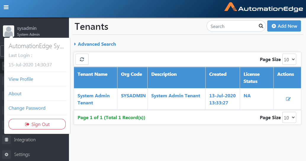

Login Details

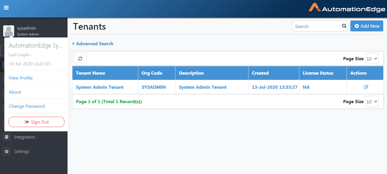

A user icon along with username is visible on the bottom left corner of the expanded menu. On clicking the user icon, you can view the last login time and the logged in username as well as other options as seen in the screenshot below. The options are listed and explained in the sections below.
Figure 4a: Click User Icon to Login details

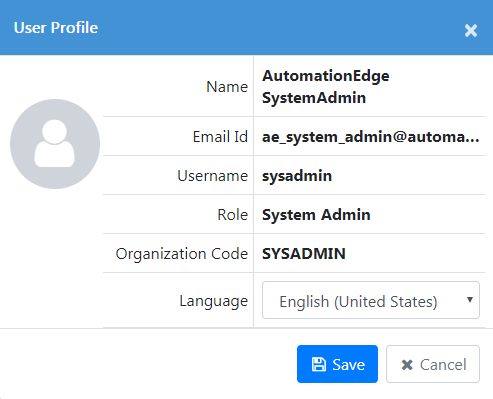

View Profile
On clicking View Profile, you can see user details as seen below.
The Organization Code refers to the Tenant.
Figure 4b: View Profile

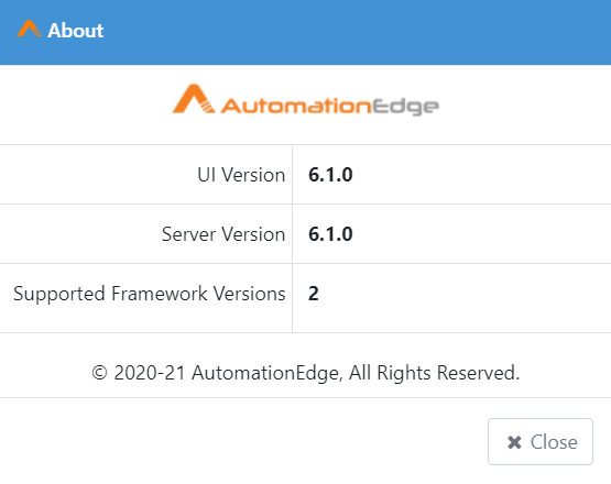

About
On clicking about you can see
  1. UI Version,
  2. Server Version
  3. Process Studio Framework Version
  4. Supported Process Studio Frameworks Version as seen in the screenshot below.
Figure 4c: About AutomationEdge

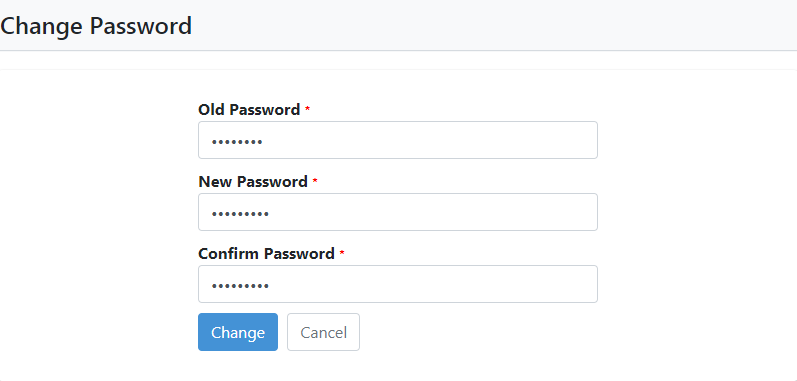

Figure 4d: Change Password Screen
  1. Enter the Old Password (Figure 3).
  2. Enter the New Password. Re-enter the new password in Confirm Password field.
  3. Click Change Password
Figure 4e: Resetting Password

  1. If you retry to set the New Password to the previous password it shows a failure message ‘Your new password must be different from your previous password’ as seen below.
Figure 4g: Previous password not allowed
Sign Out
To log out from the AE:
  1. Click the User Icon on the bottom left corner of the Home screen
  2. Click Sign-Out (Figure 5).
Figure 4h: Logging Out
